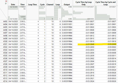

Thanks for looking into it! Almost done! The formula works and creates the continue secondary time. But it aslo needs to reset to 00:00:00 every time when the cycle number changes.
Nalrus
Level II
Re: Adding Secondary Time Scale
Found the issue. You are right, just to replace Cycle to Loop and it works. Awsome!

To make sure it separates out the Loop within each Cycle, use both as by columns.  Otherwise, Loop 1 in Cycle 2 will continue from Loop 1 in Cycle 1, for example.
(:Date + :Time) - Col Min( :Date + :Time, :Cycle, :Loop )

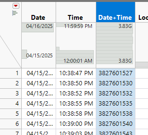

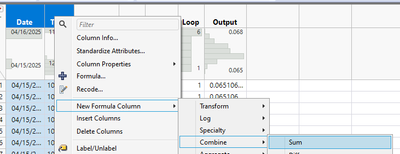

This goes outside of the topic, but it might also be worth it to combine date and time into single timestamp column. In JMP you can do this by just adding those columns together and then changing the format
Before changing the format the timestamp can look weird (number of seconds since January 1, 1904)
Format changed to y/m/d h:m:s

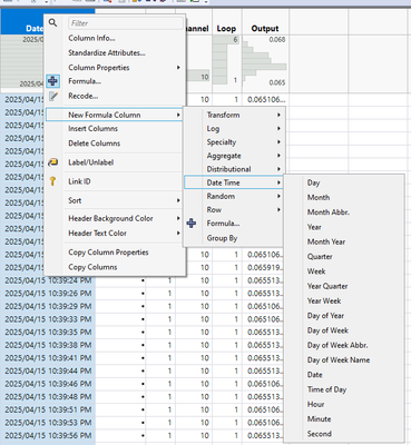

This will basically provide you with plenty of different formatting options and quick formulas from right click menu from the single column

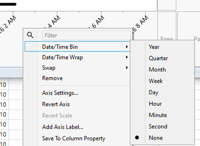

You can also use timestamp column for example in graph builder and if you wish to see data on day level, you can use date/time bin on the axis (right click on the axis)
