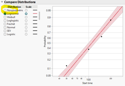

2) Use "Point" but turn off "Nonparametric"; see screenshot below. The appropriate use case for this option is that you want to emphasize the parametric fit. The adjusted KME points help you to evaluate the quality of parametric fit while using the "point" convention to convey the information.

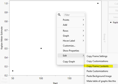

To do that, right click in the table and choose "Make into Data Table":
The generated table looks like this:
Then using Graph Build to produce a scatter plot, with Start on x-axis, and KME on y-axis. Then right click in the graph and copy the content:

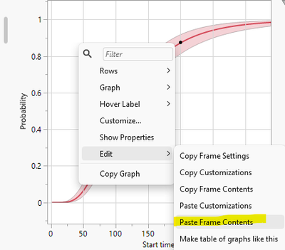

Then paste to any place that you need, e.g. back into Life Distribution:
And turn off all other Nonparametric related plot options, and you get this:
