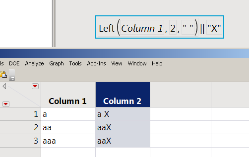

Craige_Hales
Re: Left function behavior
I think you are hitting a rule that trims trailing spaces from character data in data tables. This works:
Append a non-space after the left function's resultAppend a non-space after the left function's result
Craige
