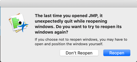

JMP Pro 13 unexpectedly quit while reopening windows
I gained the copy of JMP from the university as a student for about one year. It worked fine until this week when it keeps failing to open. I am using Mac OS Mojave.
When I open JMP, it shows "The last time you opened JMP, it unexpectedly quit while reopening windows. Do you want to try to reopen its windows again?" And lets me choose "Reopen" or "Do not reopen".

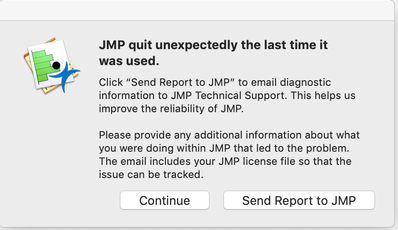

Then I click "Reopen", it shows "JMP quit unexpectedly the last time it was used." And lets me choose "Continue" or "Send Report to JMP".

Whichever I click, it then shows "JMP quit unexpectedly." and lets me choose "Report", "Reopen" or "Ignore".
When I choose "Report" or "Ignore", it then quits. When I choose "Reopen", it goes back to the first window that "The last time you opened JMP, it unexpectedly quit while reopening windows. Do you want to try to reopen its windows again?" So that it becomes a loop.

I don't think it is a license expiration situation, becaus I had it before, and at that time I was able to open JMP and renew my license. I found this note from SAS support (http://www.jmp.com/support/notes/44/128.html), saying that I can try to delete two files in the library. I could not locate the 2nd file, and after I deleted the 1st file the situation did not change.
Does anyone have similar experience before?

I emailed [email protected] as per Jim's suggestion. The reply from JMP support team confirms that it is indeed incompatibility between JMP 13 and Mac OS Majove.
Their recommendation: update to JMP 14.1.
Or, follow this post: http://www.jmp.com/support/notes/62/993.html.
