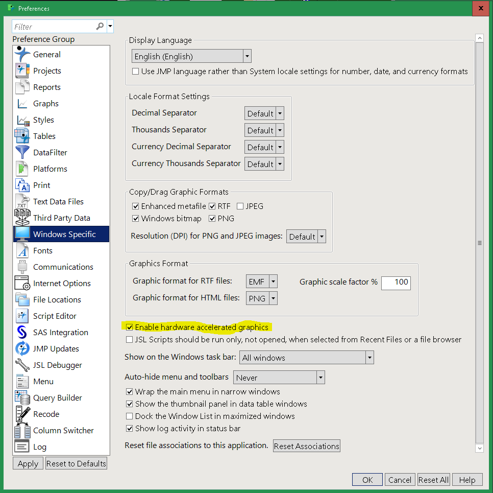

I'm not familiar with the problem. What version of JMP are you running? Try disabling the hardware acceleration:
preferences window (ctrl-K)preferences window (ctrl-K)

I disabled the hardware acceleration - some of the problem fixed. For example:
  • Filters – exist
  • Charts – I set the columns into the right fields and it’s visible
But, some other (critical) features not changed. For example:
  • Scroll up/down/left/right - very slow even for small dataset (even for ~1000 rows)
  • Select specific column/s or rows – not working

The solution (the majority of the issues) is to disable Hardware Accelerated Graphics ( File > Preferences > Windows Specific > uncheck "Enable hardware accelerated graphics).
