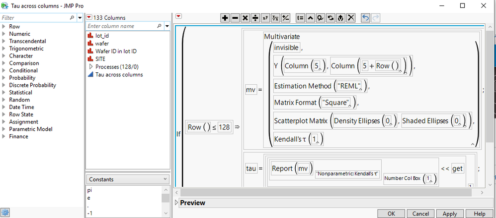

Here is the calculation across all of the analysis columns in the data table, and placed into the rows of the calculated formula column.  The data table is attached, the formula is below

When one uses JMP Platforms in a formula, just as when you use them interactively or in a script, the input to the Platform has to be columns from a data table.  Therefore, you can not reference the input by creating an input matrix.  So what I did to make your formula work, is to take advantage of being able to Exclude rows from the data table and when the platform is run, it will ignore those rows.  Here is the formula, and the output it creates:
dt = Current Data Table();
If( Row() >= 10,
	currentRow = Row();
	dt << clear rowstates;
	dt << select where( Row() <= currentRow - 10 | Row() > currentRow );
	excludeRows = dt << get selected rows;
	dt << hide and exclude;
	mv = dt << Multivariate(
		invisible,
		Y( :TimeStep, :F ),
		Estimation Method( "Row-wise" ),
		Matrix Format( "Square" ),
		Scatterplot Matrix( Density Ellipses( 0 ), Shaded Ellipses( 0 ) ),
		Kendall's τ( 1 )
	tau = (Report( mv )["Nonparametric: Kendall's τ"][Number Col Box( 1 )] << get)[1];
	mv << close window;
	If( Row() == N Rows( dt ),
	tau;
The data table
I suggest that once you have created the column, and it has run the formula, that you go to the Col Info dialog, and remove the formula.  It will leave the static values, but will not keep rerunning the formula over and over....it isn't the fastest
Jim

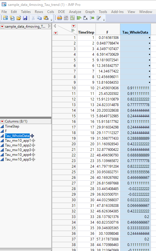

Uploading a sample data set.
My need of MK tau is on rows for  a single column. That is actually correctly done (my adaptation from your prior help) in col Tau_WholeData.
What I am really trying to do is to get a trend of a single parameter in timesteps (temporal trend if you will).
So I am trying to set a moving (rolling) window of size 10, start the window at row 10, and then move it by one record (row) - each time calculating MK Tau of the prior 10 rows .
I did similar things w/ Index function (e.g. Index( Row() - 9, Row() )) for 10 rows and I tried 3-4 different options of placing this into the  Tau_WholeData formula - so far no success.
I appreciate if you could let me know how I should change this.
thanks ...

Seeing your other answer on the linear slopes, I got  another idea of where to put the index for MK but did not work either.
attached in my latest w/ that 5th attempt
