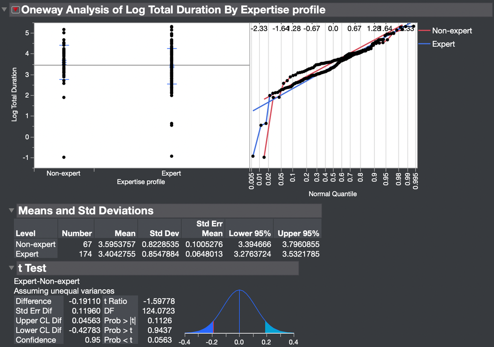

Re: Relation between categorical nominal independent variable and continuous dependent variable
Thank you for providing your data in a JMP data table, imported from your Excel workbook.
A distribution analysis shows that you have strongly right-skewed responses. The skew is apparent in the Oneway analysis.
Your hypothesis is that the mean response is higher for experts than for non-experts. The opposite is observed. The difference in the means is -3.878. The appropriate t-ratio is -0.84444 and Prob > t is 0.8.
The responses also exhibit variances that are not the same. I applied the log transform to remove the skew and stabilize the variance. The transformation revealed a few extreme outliers in both responses that are probably exerting very high influence on the statistic compared to the rest of the sample.
The t-ratio is now -1.59778 with a Prob > t of 0.9437.
I found essentially the same analysis of the Fixation Count response.

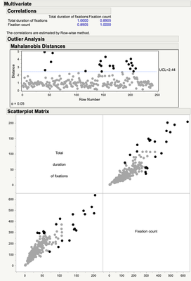

statman
Just to add to Mark's output, here is multivariate analysis on the 2 dependent variables.  You did not specify practical significance. Mahalanobis also detects a number of outliers.  The outliers could be measurement error, documentation error or some other noise variables not taken into account (one reason to keep track of time order in your data set).
Just playing here...What is it "they" are fixating on?  How do you know they are fixating on "it"?  How different are the objects being fixated on?  Is there any relationship between the object being fixated on and fixation time?  Hypothesis: We all have a bias, the bias may effect fixation time.  For example, if there is a certain feature (e.g., color or pattern) that there is a bias towards, perhaps the observer will spend more time on that feature.  In the quality inspection world, when an inspector sees one defect or area of defects, this influences where and what they look for in future inspections.

Your both analysis are great, thank you once again! I just don’t know yet how to extract the outliers from this analysis.
