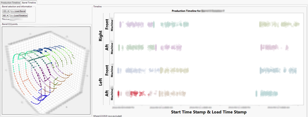

I'm currently working on a dashboard for a factory production floor. On the one side I'd like to show holes being drilled into the fuselage or the aircraft in a 3D scatterplot. On the other side I'd like to show the start times of each drill job which is basically a scatterplot with some categories on the vertical axis and continuous time on the horizontal axis. There are multiple fuselages in the data so the first step is to select one. After the selection an invisible data filter hides and excludes other points. This mainly works fine however I ran into a problem I have no idea to fix.
There are multiple machines that do the drilling. I'd like to color code all the points (both in the 3d scatter plot and in the timeline) based on the job programs loaded to the machines. When I do this by selecting :Job ID as the color variable* I notice that the two graphs use different colors for each :Job ID. When I select for example red points in the timeline, blue points get selected in the 3D scatterplot.
How to make colors match between graphs?How to make colors match between graphs?
I'm wondering if there is a way of synchronizing/matching colors on both graphs? Any ideas are welcome. I'm completely stuck.
Also, sorry about the blurring, I'm not sure if I'm allowed to show actual numbers, just playing it safe.

txnelson's idea is quite simple and elegant. I added value colors to the "Job ID" column and then under the Rows menu used "Color or Mark by Column". And immediately the colors showed up on the 3D scatterplot. The timeline plot took a little more effort to match the colors. I used two variables in the horizontal axis and graph builder automatically assigns colors to which column the points come from and overrides the row coloring from the table. But once I included the Color( :Job ID ) within the graph builder all the colors matched up perfectly!
