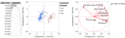

Hi all,
I'm working with a system where I need to do both variable reduction and clustering. I am studying fish behavior. I have three behavioral treatments and when I look at a PCA biplot its obvious that my data clusters into two groups and they roughly correspond to my lowest and highest treatment categories. I have an intermediate category that is split between the two. I want to use K-means to consolidate my treatment variable into two treatments instead of three to be used in later analyses.
Two questions:
1: If I am using multiple very similar highly correlated inputs (several different ways to measure body curvature) does that mess with  the clustering algorithm? Should I be doing my variable reduction before clustering?
2: I received reviewer comments saying "these clusters don't mean anything, of course a clustering algorithm is going to find differences" is there a way to address these comments referencing the way K-means clusters works.
Thanks,
Stephen

Hi Stephen2020 - You have very strong PCA results looking at the picture included. This is your statistical support for two groups. K-means uses the PCA results, so you've done variable reduction as part of doing K-means.
In the Principal Components platform, do a Bartlett Test for significance of your Eigenvalues. When you do K-means, you see these Eigenvalues under the bi-plot. If nothing is significant with the Bartlett test, you won't get very good groups in K-means. Likewise, if you don't have Eigenvalues that explain much of the variation, you don't really have much correlation structure and variable reduction isn't doing much (and hence K-means won't magically produce clear groupings).
You can use the CCC to test for other numbers of clusters, and if you get 2 this would be additional support that 2 is a good number of clusters. The CCC is the Cubic Clustering Criteria and try a range of clusters, like 2 to 5. The documentation has a reference for this method. If you don't get 2, it's not a strong justification for NOT using 2 groups (because your expertise is guiding your choice of 2 groups). CCC is a guide and supporting evidence only.
Finally, use the means and standard deviations reported for your groups in K-means. Do the standard deviations  overlap between clusters (high of one overlap with low of the other - you'll have to calculate this)? If not, then you can make a statement about that as well.
The one cautionary note is that anything you put into PCA and K-means can't be later pulled out and used as a Y variable for further analysis.
