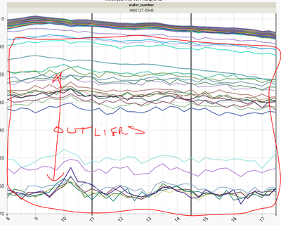

I have a table that has ~ 4,000,000 rows of data that include a very large variety of test conditions. I use the Explore Outlier function within JMP to change cell values that meet the outlier criteria to missing. I then want to take the row column id associated with the missing values and exclude them from the main data set. I have tried Get Rows Where( Is Missing( :col ) but i can't figure a way to effectively translate it to the main table. This is the best i can come up with at this moment. Any and all help is always appreciated.

Thanks for the reply Mr. Nelson. The problem isn't finding the missing rows. The problem is the time it takes to get the row column id's that are missing and Hiding and Excluding them in the main table... If you were to plot x = Input and Y = Output as you see in the example. The remove outliers will find the data that is outside the distribution and change it to missing on the dt_screen. I want to be able to take row column id's and hide / exclude them in the main table to clean up this plot..
