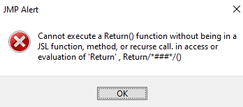

Re: Jump out of a function?
I am getting an error when trying to exit a function with return().
I get the error when I make a button box
bb = Button Box("SpecsAuto")
then attach a function
bb << Set Function( Return() )
then click the box.
Here is demo code to reproduce the error:
nw = New Window("Win1");
nw << Append(bb = Button Box("SpecsAuto"));
bb << Set Function(
	Print("A");
	Return();
	Print("B");
bb << Click();
hogi
Level XIII
set function() also works if no function is provided - like in your script.
To use the magic of return(), you have to put it inside a function:
bb << Set function(Function({},
	Print("A");
	Return();
	Print("B");)
bb << Click();
