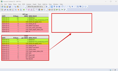

Hello guys,
I calculated 2 tables HOT_per_skew and COLD_per_skew
when I added these 2 tables to the Journal, I got the vertical position.
My question is, how can I present these 2 tables in a Horizontal position by JSL script?
HOT_per_skew << Journal ( ) << Close Window ( );
COLD_per_skew<< Journal ( ) << Close Window ( );

jthi
Re: Journal in 2 or 3 columns
I think you can just wrap them in H List Box (Or Lineup Box(N Col(2))
Names Default To Here(1);
dt1 = open("$SAMPLE_DATA/Big Class.jmp");
dt2 = open("$SAMPLE_DATA/Big Class Families.jmp");
Current Journal();
H List Box(dt1 << get as report, dt2 << get as report) << journal;
Close(dt1, nosave);
Close(dt2, nosave);
-Jarmo

Dennisbur
Level IV
Thank you!
