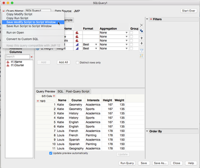

Jeff_Perkinson
Re: Joining multiple tables in jsl
Nearly everything you can do interactively you can do through JSL and JMP will usually give you the script to do it.
Look in the red triangle hotspot at the top of the  JMP Query Builder and you'll find the options to get the script.

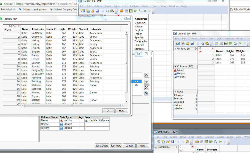

powerpuff
Level IV
Hi Jeff,
The preview table in the image is what I am getting
Whereas what I want is something like this:

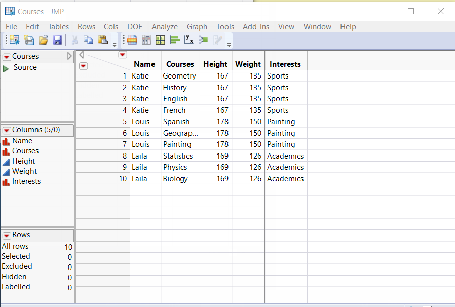

@powerpuff
      Maybe something like this ?
Clear Log(); Clear Globals();
// I am assuming you have the data tables open. If not you will need to open the data tables and capture their references
// Getting references to the data tables
dt1 = Data Table("Courses");
dt2 = Data Table("HeightAndWeight");
dt3 = Data Table("Interests");
// Updating data table 1 to get all data in one place
dt1 << Update(
				With(dt2 ),
				Match Columns( :Name = :Name ),
				Add Columns from Update table( :Height, :Weight )
dt1 << Update(
				With(dt3 ),
				Add Columns from Update table( :Interests )
Please note that the resulting table will look like this which is a slight modification of your ask but fair representation of the data. Is this what you already had when you tried "Join Tables" and is this not what you wanted ? I see that in the desired output you have shared , you are essentially concatenating the data horizontally to some extent
Best
Uday

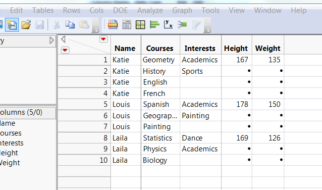

powerpuff
Level IV
Hi Uday,
Thanks for the response but the table in the end result has repetitive values. That was not what I was looking for.. Is there any way I could get the output table as I mentioned in the question?
