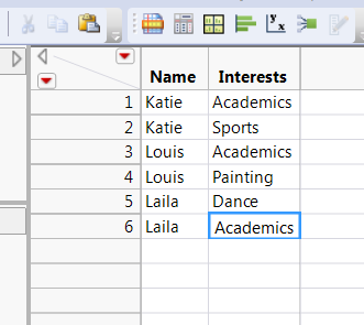

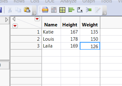

For example, I have 3 tables,
Table 1:
Table 2:
Table 3:

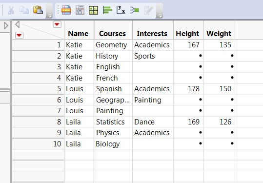

The final table I want should look something like this:
I tried using the 'Join Table' option but it doesn't give the output I want. Is there any other way to do this? Thanks

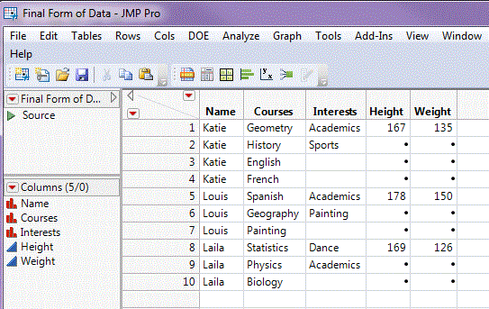

Here is a script that joins your data as perscribed.  The final table is showned below

Jim
