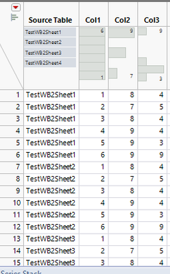

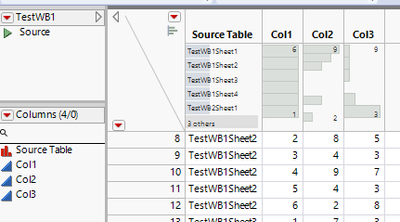

Tables before concatenate:
After concatenate:
After split:
-Jarmo
