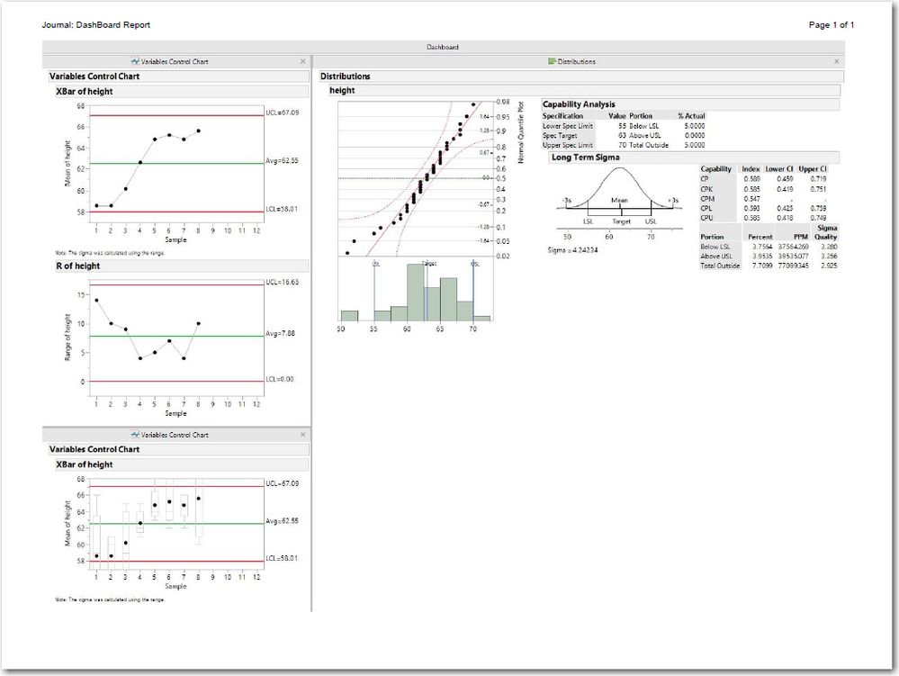

Here is an example that uses a sample application builder.  I have JMP Pro, so I am not sure it will work.
However, if you know the name or can get a handle to the dashboard window you just created (see comment lines ) the rest of the script might work.  Note you might have to scale your page to get the display you want.

Screen capture of PDF fileScreen capture of PDF file
