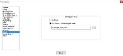

  4. If you have cloud settings setup in in N++, go there if not go back to the install directory
