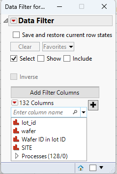

  The issue I'm having is that due to the many columns in my data table, the data filter shows up with its default size settings, and it's much larger than I'd like. Using the Semiconductor Capability.jmp file, it looks something like this (default):

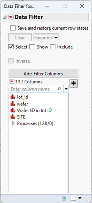

  But, I'd really like it to show up in a size like this (ideally modified via JSL):

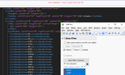

  I was thinking of trying to force it via the list box NLines() command by accessing the Tree structure, but that didn't work. I also tried setting the height of the panel box or data filter platform using <<Height(), and that doesn't work either. Also tried the <<Set Max Size command for the DisplayBox, but that doesn't work.
  Is there a way to force the Data Filter Outline Box or Panel Box that it resides in (in my script) to be a certain size?

lbb = nw << XPath("//ListBoxBox");
lbb << Set N Lines(5);
Data Filters have very messy structure and sometimes manipulating how they look can be quite difficult but in this case getting reference to listboxbox seems to work

  Awesome, thanks for the quick reply and solution! Yes, accessing the ListBoxBox worked -- I had tried doing that through looking at the tree structure, but I must have been accessing an incorrect layer in the tree or nothing at all. I really need to get better with how to use XPath because that makes accessing the different layers so much easier. In this case, I simply wanted fewer lines in the listboxbox for aesthetic reasons.
