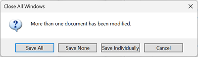

Quick question for those of you who may know -- if you have an <<On Close() method for a window (say for file-cleanup or some such thing), and a user has multiple edited files open -- if they CTRL-Q and get the popup about unsaved work -- if they then click "Save None", then all windows are immediately killed and the <<On Close() script is _NOT_ called for any of the windows.  It is extremely common for users to exit JMP this way, thus pretty much always bypassing all <<On Close() scripts.

Note that I've only seen the issue when the ^Q causes the below popup (multiple unsaved files) and the user clicks "Save None"

@jschroedl has there been an update with this?  I'm also noticing the same issue when a user selects multiple windows from the Window List and closes them all at once (usually by pressing Delete after selecting them) and if there is a popup about multiple unsaved files, the Save None will close without triggering the OnClose -- exactly the same as above except they're not quitting JMP.
This can leave many resources dangling as the cleanup scripts never run.
