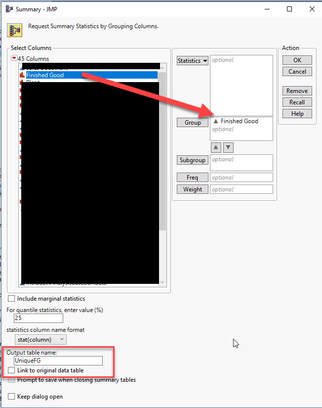

Proposing a Summary solution for JMP users on the beginner (my) side of the spectrum.
In this example we want a list of unique finished goods from a list of customer orders. I won't link the table and I'll give the Output Table a name.
On the original data table go to Tables -> Summary
Drag Finished Good from the select columns over to Group on the right.
Give the Output table a name, in this case UniqueFG.
Uncheck Link to original data table.
Click Action OK.

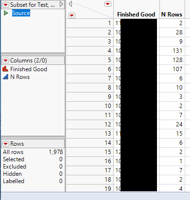

The resulting data table is a list of all unique FG and the count of rows.
