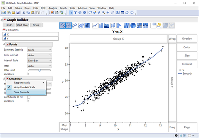

how can i export or save the smoothing in a table.
Hey people,
I have a plot of 12000 values ​​here and can show the smoothing in the graph, but I would like to export this smoothing as a table (values) so that I can later calculate the integral.
3 REPLIES 3
Thierry_S
Re: how can i export or save the smoothing in a table.
Hi,
In the GrapBuilder window, look for the "Smoother" item (mid to lower left), click on the red triangle and select "Save Formula".
Best,
TS

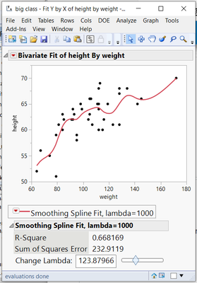

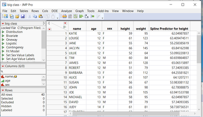

txnelson
If you use Fit Y by X, and perform a Fit Flexible(Spline), you can set your smoothing function and then Save the Predicteds.
Jim
