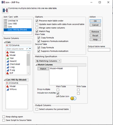

jthi
Re: Get unique column values & use them for filtering / cleaning up in a different table
These methods will be fast for that amount of rows!
There is one more solution that came to my mind, you can first create Summary table and then Join that to the table you want to remove found values from.
Using JMPs Cars.jmp and Cars 1993.jmp sample datas as example. Cars 1993 will be one data we will filter Cars with by using Model column.
1. Create Summary table from Cars 1993 with Model as Group
2. Join that new summary table to Cars table with following settings:
3. From new Match Flag column you can see two values: Both and Main. Both means that the Model can be found from both of datasets
I think you can do this directly with Cars 1993 but you have to be careful with duplicates (Drop multiples With Table might solve that, not sure). Also in this case you would want to choose columns you want to keep, as there will be duplicates (at least with this example).
These both can also be scripted fairly easily as JMP can do most of the scripting.
-Jarmo
