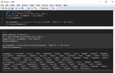

With Summarize the results are saved in variables with the names specified.
You can see them in Log window: View/Log (Ctrl+Shift+L shortcut) or right click on script editor and enable Show Embedded Log (I suggest enabling this from preferences to be shown always).
Embedded log:

Re: How to Identify Unique Values in a Column from a Data Table (to a Scripting Newbie)
Thanks, that works perfectly.
