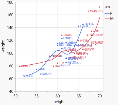

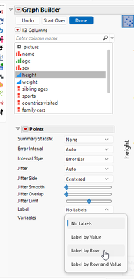

 you have to activate the labels in the control panel:
:name<< Label( 1 ); // no effect, label is already activated by default for this column
Graph Builder(
	Size( 451, 447 ),
	Graph Spacing( 4 ),
	Variables( X( :height ), Y( :weight ), Overlay( :sex ) ),
	Elements( Points( X, Y, Label( "Label by Row" ) ), Smoother( X, Y ) )

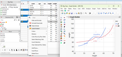

As an alternative, you can tag rows with the "label" flag - and show labels for the tagged rows:

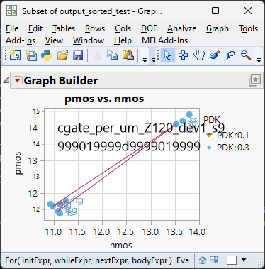

On your issue: solve the issues for single graph first (so drop the loops and use one subset). After you get that working as intended, then add the loops as it makes it much easier to debug. When I run your plot for one I get this
My guess is that your problems are within the graphic script. I'm not exactly sure what you are trying to do within it?
