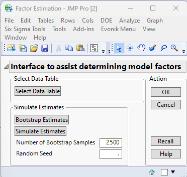

  I'm working on a script where I need to reference a Report window. Specifically, what I'm trying to automate is using the Simulate() function of some parameter estimates. I know that inside this report, I need to send the Simulate command to the Number Col Box(8).

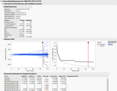

  The problem I have is that I have a main user interface window where the user can click a button box to either Simulate the parameter estimates or Bootstrap them. The issue is that in the main window (see image below) when the user clicks on either Button Box, there is a command in my script where I'm trying to get the current report, which is open in another window.
report window:
But, when you click the button, the JSL command obj = Current Report() returns a reference to the main interface window NOT the report that I'm actually trying to reference. If I click on the report window and then run the script, it works.
