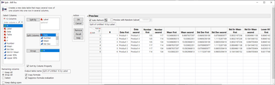

I attached a document "Untitled.png" with screenshots to (hopefully) better explain my request.
Thanks!

You could for example first stack your group column, update it with the results and split it again.
This example doesn't take into account that there can be multiple Metrics

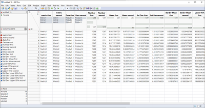

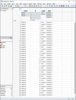

Hello Jarmo,
Stack > Update > Split is a great idea!!!
I have been able to implement it successfully, but my code is a bit dirty (a lot of For() loops, intermediate steps,...).
Instead of:
- Concatenate the table multiple times
- Then populating a column from a list of repeated metrics
I would like to become better in optimizing my code.
Is there a way to populate dt5 in a more cleaner/optimized way? (use native JMP commands maybe?)
I would love your suggestions on this
But anyway, thanks a lot for helping me on this :D
-Voiz

dt4 = dt3 << Stack(
	columns(:first, :second),
	Source Label Column("Label"),
	Stacked Data Column("Data"),
	"Non-stacked columns"n(Keep(:Metric, :R))
Close(dt3, no save);
dt4 << Update(
	With(dt2),
	Match Columns(:metric = :Y, :Data = :Level)
dt_split = dt4 << Split(
	Split By(:Label),
	Split(
		:Metric, :Data, :Number, :Mean, :Std Dev, :Std Err Mean, :Lower 95%, :Upper 95%,
		:Std Dev Lower 95%, :Std Dev Upper 95%
	Output Table("untitled 19.jmp"),
	Remaining Columns(Drop All),
	Sort by Column Property
-Jarmo

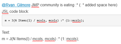

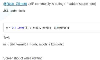

Re: [JSL] Script for Two-One Side T-Test on a large number of metrics
I have attached the part of code which breaks in community as a screenshot
It is element-wise multiplication of matrices E Mult()
@Ryan_Gilmore JMP community is eating :* (: * added space here)
JSL code block:
m = J(N Items(l) / mcols, mcols) :* (1::mcols);
Text:
Screenshot of while editing
Screenshot from Preview
-Jarmo
