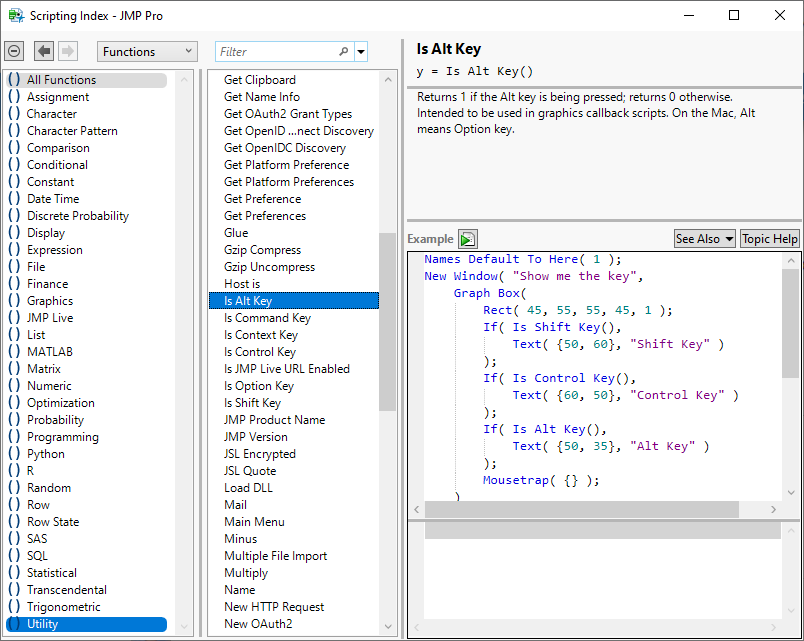

You can search the Scripting Index for functions. There is a group of Utility functions that includes inquiries about modifier keys that are current pressed.
