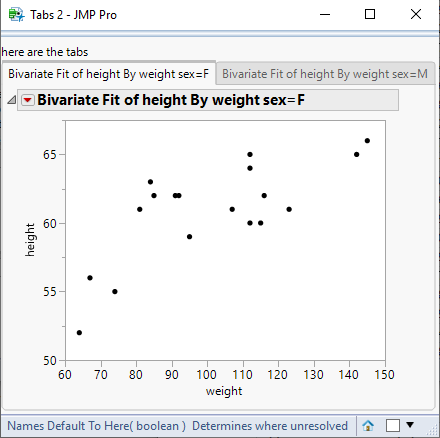

I am trying write a script that saves a report by groups into tabs. As an example let's consider a bivariate analysis of height vs weight in the Big Class example data set. I would like to carry out that analysis by column sex and output the analysis for :sex == "F" in one tab and :sex == "M" in another. Now this should of course work with any number of value levels in the groupby column. The only thing I can think of doing is to subset the datatable but then I end up with a bunch of data tables that I cannot close without loosing my report. Any suggestions on how to do this without subsetting?

Here is one way of doing it
names default to here(1);
dt=open("$SAMPLE_DATA/big class.jmp");
// Generate the output in an invisible space
biv = dt << Bivariate( invisible, Y( :height ), X( :weight ), By( :sex ) );
// Create the window, with the first tab
nw=New Window("Tabs", text box("here are the tabs"), tb = Tab Box((report(biv[1])[outlinebox(1)])<<get title ,report(biv[1])));
// Generate the remaining tabs
For( i = 2, i <= N Items( biv ), i++,
	tb << Insert( i, (report(biv[i])[outlinebox(1)])<<get title, Report( biv[i] ) )
// Close the invisible output
biv<<close window;
Jim

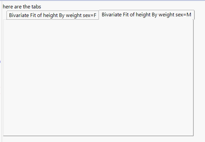

After running the script, i can not find analysis output in Tab2. Can you let me know why? Thanks.

Jim, Thank you for your script. I used your jsl as is, I am able to create the tabs , but my 2nd tab is blank. Do you have any idea why this might be happening? Any help will be appreciated
txnelson
Re: JSL: Save report by group into tabs
I suspect you are running JMP 13 or earlier.  The code only works for JMP 14 or above.
