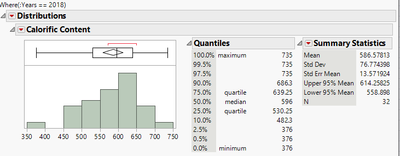

I think i have an issue with my script too
When i run my distribution By years & save it,
While running it again it only pull 2018 Year data, see snippet & script below.
Distribution(
Arrange in Rows( 3 ),
Continuous Distribution(
Column( :Calorific Content ),
Horizontal Layout( 1 ),
Vertical( 0 )
Where( :Years == 2018 )
txnelson
Re: JMP Distribution Platform not arranging Distributions in Rows
There are 2 separate selections when you Save Script for Distribution.
  1. Save Script
  2. Save By Group Script
You apparently selected the Save Script, which will output the script for just the Group you selected the red triangle from
You need the Save Script , which outputs with the By clause
Distribution( Continuous Distribution( Column( :height ) ), By( :age ) );
