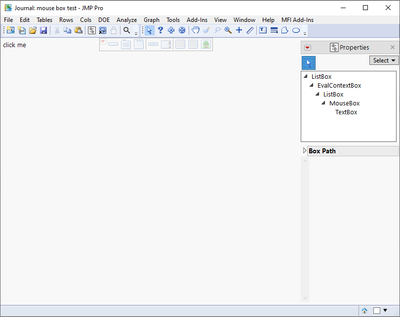

Also this small change might prevent the mouse box from breaking and will keep it in journal but I'm not sure if you can build it this way (create window as journal window)
-Jarmo

ah... half of my message was left out (property tree is there but no script example)! It seems like you can keep the mouse box if you initialize your window as journal window (<< Journal)

I've been playing around with this off and on, to clarify in the small chance that someone else has this issue, while opening the new window as a journal window does indeed initially work as expected, actually saving then re-opening the journal strips it of any Mouse Box instance again. I have found that opening a previously saved Journal from JMP 16 with a working Mouse Box, then saving with JMP 17 strips the Mouse Box as well. This seems to be a change to how Journals are handled in JMP 17.
