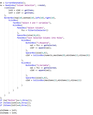

Hi,
I am intending to build a Graph Builder for visualizing different columns of data each time. The Graph Builder should be able to take whatever many inputs columns (as long as it's less than 8). I built an input GUI but I dont think the y-values are recorded. How can I correctly pass the selected Y column data to the graph builder? Thanks!

Please use the txnelson_0-1719510632610.png icon to display your JSL.  It allows for the reader to test your code and provide responses.  Pasting in images of your code will not allow this, and therefore many possible responders will opt not to respond because of the time it would take to retype in your JSL

names Default To Here(1);
MyGraph = Function ({yCol,xCol},{default local},
	vlb = VListBox(
		Graph Builder(
	Size( 1255, 981 ),
	Show Control Panel( 0 ),
	Variables(
		X( Eval(xCol) ),
		For(j = 1, j <= Min(8, N Items(yCol)), j++,
                Y( Eval(yCol[j]))  // Evaluate each yVar
		Group X( :Temperature )
	Elements( Points( X, Y( 1 ), Y( 2 ), Y( 3 ), Y( 4 ), Y( 5 ), Y( 6 ), Y( 7 ), Y( 8 ), Legend( 11 ) ) ),
	Local Data Filter(
		Add Filter(
			columns( :Test Stage, :Sublot, :Temperature, :Soft Bin ),
			Display( :Test Stage, N Items( 4 ) ),
			Display( :Soft Bin, N Items( 15 ) )
	return(vlb);
dt = CurrentDatatable();
nw = NewWindow("Column Selection", <<modal,
	<<onClose(
		lstX = clbX << getItems;
		lstY = clbY << getItems;
	BorderBox(top(10),bottom(10),left(10),right(10),
		VListBox(
			TextBox("Select X and Y variables"),
			HListBox(
				PanelBox("Select Columns",
					fcs = FilterColSelector()
				SpacerBox(size(10,0)),
				PanelBox("Cast Selected Columns into Roles",
					HListBox(
						ButtonBox("Y,Response",
							sel = fcs << getSelected;
							clbY << append(sel);
						SpacerBox(size(6,0)),
						clbY = CollistBox(numeric,maxitems(8),minitems(1),nlines(8))
					HListBox(
						ButtonBox("X,Variable",
							clbX << append(sel);
						clbX = CollistBox(maxitems(2),minitems(1),nlines(2))
if (nw["Button"]==-1,throw());
if (Nitems(lstX)==0,throw());
if (Nitems(lstY)==0,throw());
yColName = lstY;
xColName = lstX;
show(lstY,lstX);
NewWindow("My report",
	VListBox(
		MyGraph(yColName,xColName),
		HCenterBox(
		btn = ButtonBox("show distribution")
btn << setScript(
MyHistograms()

Thanks for the advice, here is my full script.
