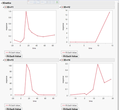

JSL: Layout( ‘Arrange in Rows’) is lost during jounalizing by scripting
Dear JMP Community,
I stumbled across the following issue while scripting (example attached):
  • If I use the following script, “jrn1 << Journal;” results in the transfer to the journal, but without “Group Options( Layout( ‘Arrange in Rows’, N Across( 2 ) ) ),”.
  • If I use the manual option (Edit >> Journal or Crtl + J), the two-column layout is retained.
Is there another “journal syntax” that retains the layout that I am not aware of or is this a bug?
Do I have another option than formatting the journal layout via “H List Box ()”?
Best,
Steffi
kin1 = current data table();
jrn1 = kin1 << Bivariate( Y( :response ), X( :time), Size(400, 325), Fit Each Value( {Line Color( {212, 73, 88} )} ), By( :ID ), Group Options( Layout( "Arrange in Rows", N Across( 2 ) ) ), ); Current Report()[OutlineBox(1)] << setTitle("Kinetics"); //Adjust the header retroperspectively jrn1 << Journal;

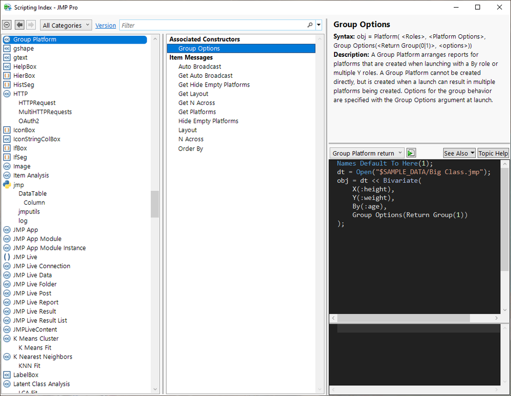

jthi
Re: JSL: Layout( ‘Arrange in Rows’) is lost during jounalizing by scripting
Save Journal overwrites graphs of Fit Group is similar post as this but If I remember correctly there is one even better method BUT it is extremely difficult to find or remember... if I manage to find it, I will edit this response.
Edit: Finally managed to find it. It is extremely difficult (in my opinion) to find but here it is: use Return Group(1) on Group Options (I have added this to my personal tips&tricks file so hopefully I will find it easier next time someone has similar problem)

Names Default To Here(1);
Open Help(
	"Scripting Index",
	Search(
		Term("Group Options"),
		Match(
				{"Contains Terms",
				"Match All Terms",
				"Ignore Case"}
	IndexContext(
		Category("All Categories"),
		Object("Search results"),
		Method("Group Options")
-Jarmo
