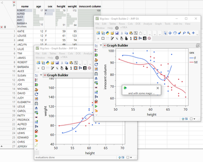

My guess is that it is caused by using translated column name and same name in other column + relying on JMP's loose name rules (file Name instead of File Name for column referencing)
New Table("where_is_the_bug",
Add Rows(2),

Most definitely a bug considering JMP's rules for names but there are easy workarounds.

More than a guess : )
It's interesting ...
that JMP keeps the column name "File Name" internally for the second column - despite the conflict with the other column just save the table script and you will see something like in @jthi 's post
that JMP uses this internal name to find the column - although the "File Name 2" in the table view besides "file Name", you can also access the column via "File Name 2"
that JMP first scans the localized column names - and THEN the original column names (otherwise it would find the first column). The sequence seems to be: 1) column name a: just exact matches 2) localized column names - even approximate matches 3) column name b: approximate matches
where the additional column came from. I tried Concatenate and Update - with English and German settings ... with JMP 18.1 and JMP19EA4.

As a consequence - a JSL code is very "fragile" if a column name is written slight different to the actual column name:
Somebody can add a new column with alternative values. If one of the localized names is similar to the original column name/ the reference in the script JMP will prioritize the new column. This can lead to surprising plots - maybe less obvious ones than this one: <- Graph Builder will use this one
column name: weight
JSL script: Weight
alternative column (at the end of the table): wEiGhT <- Graph Builder will use this one
Using the data table that @hogi supplied, it get the blank values that were originally shown. I then noticed that there is a column called File Name 2 that has blank values for the 2 rows. I then deleted the column File Name 2 and reran the script, and the script displayed
If you change the name of the column File Name 2 the script will also run correctly
