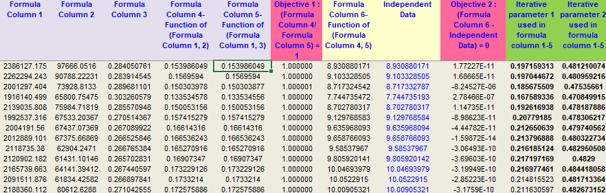

I'm not sure if this helps because I have to anonymize the data, but basically this has been what I was trying to replicate or improve upon from Excel:
In this case, I'm using a macro + Excel's solver to iterate parameter 1 and parameter 2 to reach objective 1 and objective 2
Thanks

In this case, I don't think solving multiple equations simultaneously is the direction to go, because every row in your table involves two variables: parameter1 and parameter2. And they are different variables from row to row, though they have the same name from equation to equation and you put them under the same column.
For simultaneously solving multiple equations using the suggestions that I gave, equations use the same set of variables from equation to equation. Every variable should have just one value.
What you need to do is to translate what you have done in Excel Macros to JSL, e.g. you need to write a bigger JSL loop to go through every row iteratively.
For solving equation under a nonlinear constraint, one of my suggestions was to convert a constrained problem to an equivalent unconstrained problem. Assume your constraint is an equality, the following example tries to find the solution to y-exp(x)=0, under constraint y==exp(-x). The solution is the intersection of the two curves, which is at (x,y)=(0,1). The minimizing objective is sum of squared errors of the target equation y-exp(x), and the violation of the constraint y-exp(-x)=0. Notice k is a penalty on the violation , and k is rather large.

Thank you very much for your persistence in helping me resolve this issue. I referenced how you converted it to an equivalent unconstrained problem then minimizing the sum of squared errors of both the target equation and the constraint. While I did not need to use a penalty term, the solution more or less matches what I see in Excel.
It takes about 2-3 minutes to solve for 1100 rows of cases (which I think is absolutely reasonable given how convoluted my equations are), after I set it such that the starting value begins from values solved from the previous row of data.
