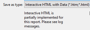

Before JMP 18, only one local data filter was supported in an Interactive HTML web page. So, even if you disabled the Include mode, the second local data filter would remain disabled.  You would see the following message in the export dialog:
JMP's log will include a message describing the limitation:
"Interactive HTML: Only one data filter per report is interactive."
In JMP 18, since we added support for multiple local data filters in Interactive HTML, all local data filters in a Dashboard or JMP Application exported as Interactive HTML will be interactive.
This is a great example of the fact that our Interactive HTML capability is a subset of the functionality available in JMP, but with each release, we expand the subset to add functionality prioritized by the feedback we get from users.
