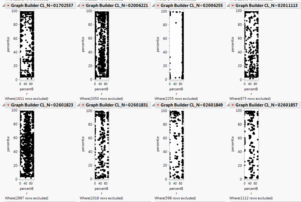

I want to plot multiple XY graphs, representing steel defects over width (X) and length (Y).
I want to arrange them in rows in a grid, by the coilnumber (product number).
I use the following code:
Names default to here( 1 );
Fit Group(
	Graph Builder(
		Size( 100, 300 ),
		Show Control Panel( 0 ),
		Show Legend( 0 ),
		Show Title ( 0 ),
		Variables( X( :PercentBr ), Y( :PercentLe ) ),
		Elements( Points( X, Y, Legend( 1 ) )),
		By( :cl_n )
	<<{Arrange in Rows( 15 )}
However I can't get rid of the title.
Ideally I only want to have the coilnumber: eg. '01702557' for the first cell in the picture instead of 'Graph Builder CL_N=01702557'.
This way I can plot more products on one page.
Thanks!
Peter

txnelson
Re: JMP multiple XY plots in a grid without headings
Here is what you asked for.  Not sure it is exactly what you want, but you should be able to see some options on getting it to where you want it.
dt=current data table();
summarize(dt,levels=by(:cl_n));
fg=Fit Group(
	Graph Builder(
		Size( 100, 300 ),
		Show Legend( 0 ),
		Show Title ( 0 ),
		By( :cl_n )
	<<{Arrange in Rows( 3 )}
	report(fg)[outlinebox(2)]<<set title(
		word(-1,report(fg)[outlinebox(i)]<<get title,"="
for(i=3,i<=nitems(levels)+1,i++,
	report(fg)[outlinebox(i)]<<set title("")
Jim
pmroz
Actually you can drag CL_N to the Wrap role and get this:
Here's the code:
Graph Builder(
	Size( 1806, 953 ),
	Variables( X( :percentLe ), Y( :percentBr ), Wrap( :CL_N ) ),
	Elements( Points( X, Y, Legend( 13 ) ) )
6 REPLIES 6

pmroz
Here's the code:
Graph Builder(
	Size( 1806, 953 ),
peter_caenen
Level II
Thanks a lot!
This solution works even better for me.
It is for me a very good way to plot the defects on hundreds of coils in one image:defects grid.png
