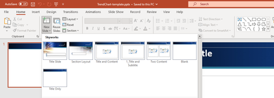

Currently, inside my template.pptx, it only has 1 slide inside it. A empty title slide. But the title slide is of the desired pptx theme.

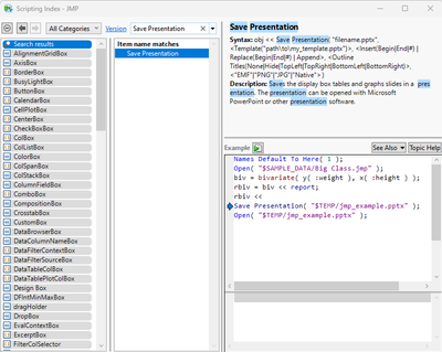

I checked the Scripting Index but had some trouble understanding it.

I created the template by creating one slide on PPT, right clicking the layout and selecting 'Title and Content' - since this is the first (and only slide) when JMP selects the template it is forced into the Title and Content format (or any other format you choose). I don't see any reference to "Slide Layout()"  that @EmilyMark mentioned in the JSL Scripting Index and couldn't get that to work either so I don't know if they can clarify further.

This is my template. Note it only has 1 slide.
Note, the name of the slide is "Title and Content".
