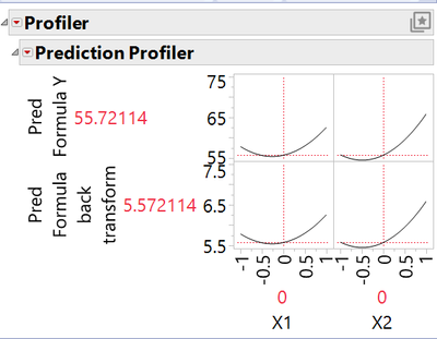

Hi @SaraA ,
Apologies, if you bring in both of the columns it should come up in the Profiler.
If you put both of the formula columns in the profiler option it should show the relationship of both

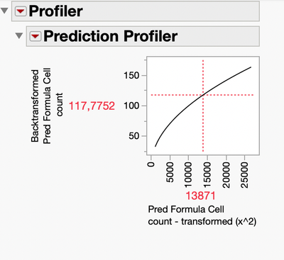

Hi Ben,
I have tried this but when I try to generate a profiler with the backtransformed data, it does not contain the factors of my original model. It just plots the Predicted Y on the X axis and the backtransformed predicted Y on the Y axis.

Hi Ben,
The problem is that this is what I get when I ONLY select the backtransformed column:

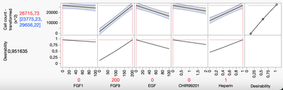

I don't want this profiler. I want the backtransformed data on the Y axis and my factors (I have 5 of them in my original model) on the X axis. Like this:
I don't know why the profiler does not show this factors when I use the backtransformed column.

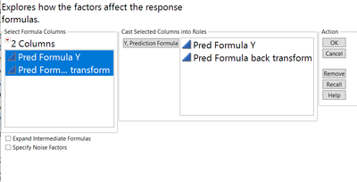

Hi @SaraA,
If you have a backtransformed formula column of Y (based on the prediction formula column Y found with the model), selecting this backtransformed formula column of Y and checking in Profiler "Expand Intermediate Formulas" will display only the original predicted Y depending on the factors (and not depending on the transformed Y).
Hope this may help other users facing a similar problem,
