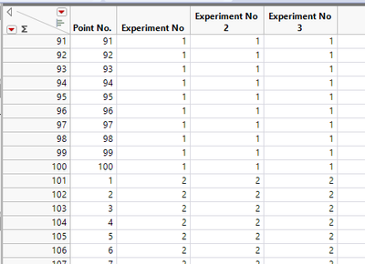

AI is pretty bad with JSL.  Applying my solution is straightforward.  Also, I tried your last formula, and it worked fine.
dt = New Table( New Column( "Point No.", Set Values( Repeat( 1 :: 100, 4 ) ) ) );
dt << New Column( "Experiment No", Numeric, Formula( Length( Loc( :Point No.[1 :: Row()], 1 ) ) ) );
dt << New Column( "Experiment No", Numeric, Formula( Col Cumulative Sum( If( :Point No. == 1, :Point No., 1, 0 ) ) ) );
	Numeric,
	Formula(
		If( Row() == 1,
			1, // Initialize experiment number as 1 for the first row
			If( :Point No. == 1 & Lag(:Point No.) != 1,
				Lag( :Experiment No ) + 1, // Increment experiment number if "Point No." resets to 1
				Lag( :Experiment No, 1 ) // Otherwise, keep the same experiment number

Create a new column and set this as the formula:
Col Cumulative Sum( 1, :Column 1 )
Column 1 being the column that contains the measurement numbers.
Brain fart.
mmarchandFSLR
Level VI
Re: How to make a new column with experiment number in a data table with stacked repeating continuous data?
Length( Loc( :Column 1[1 :: Row()], 1 ) )
That formula works.
mmarchandFSLR
Level VI
You can use Col Cumulative Sum(), but it's not as pretty.
Col Cumulative Sum( If( :Column 1 == 1, :Column 1, 0 ) )

I have also tried this, but so far all rows in my new column have a value of 1. Can you see what is not working?
dt = current data Table () << New Column("Experiment No",
Numeric,
Formula(
If( Row() == 1, 1, // Initialize experiment number as 1 for the first row
If( :Point No. == 1 & Lag(:Point No.) != 1, Lag(:Experiment No) + 1, // Increment experiment number if "Point No." resets to 1
Lag(:Experiment No, 1) // Otherwise, keep the same experiment number
	Numeric,
	Formula(
		If( Row() == 1,
WhiteCow2000
Level II
Thank you so much for all your help! It works now with both If formula and the Length formula!
