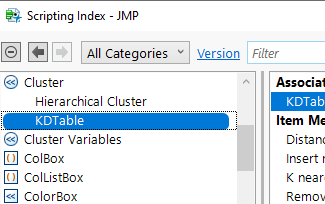

I thought about my issues with the search function:
https://community.jmp.com/t5/Discussions/JMP-Scripting-Index-feedback-and-discussion/m-p/583011/high...
I think it's because of this:
- What I really want is: To select a specific object or display box in the list on the left
- But instead of scanning the list and selecting the correct entry manually, I am lazy and use the search function on the top
 ... which actually scans the whole scripting index and shows matches in the center
The good thing:  one of the entries corresponds to the "object" on the left and I can highlight and select it
The bad thing: I have to get rid of the restriction by the search, so I have to remove the text in the search function.
With this insight:
Actually, for me it would help if there was a search field at the top of the list on the left with the functions/objects/displayBoxes.
So my question to the community?
same for you? would you benefit from a search filed?
I just tried to select any entry in the list and started typing. Sometimes this works as intended and the correct entry is marked - but often it gets trapped in a subtree. e.g. after typing "K":
