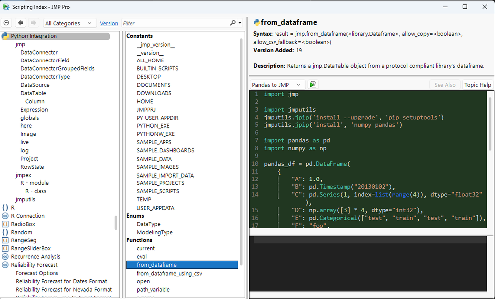

Hi @altug_bayram,
"I wish there was some sort of template w/ examples"
The Scripting Index has some quick Python examples. Python Integration > Functions > from_dataframe has a few examples that might be what you're looking for.
Not exactly the questions you're asking, but maybe helpful:

Ultimately, there shouldn't be any technical hurdles sending a data table to python, using python-specific libraries, then bringing the data and/or images back to JMP.
I've attached an example script that uses the ephem library to calculate planet locations, then pulls the data back to JMP for visualization. Note lines 9-10 install the ephem library from within JMP's Python environment and only need to be run once.
