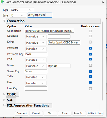

For Data Connectors (introduced in JMP 18), you'd add the Catalog=<catalog-name> in the Connection value like:
The other values are probably OK. With a JMP 18 Data Connector, ODBC configurations are obtained from the ODBC Manager and converted to a Data Connector.
