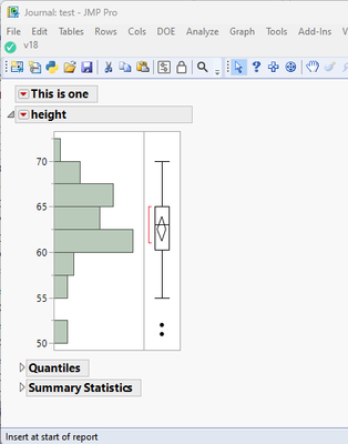

Is there a way to access each individual report inside a journal as a script. i am writing a script where i want to access each report inside a jounral and modify some of their properties using jsl script? so is there a way to access individual script of reports in journal and modify them in jsl to reflect on the journal ? kindly guide
1 REPLY 1
txnelson
Re: Access script of each journal outline box
If you create a journal
Names Default to here(1);
jr = new window("test", <<journal);
and then you create a structure within the journal by either using the tool bar within the journal, or selecting and dragging outline boxes into the journal
You can access the script for the outline box as
theScript = jr("height")<<get script;
