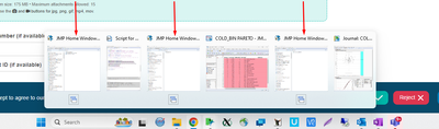

Hello guys,
I had a strange issue the last week. When I click on any JMP file, the file opens with a new Home Window of JMP.
The problem is, when I would like to analyze between 2 opened files, I cannot do it because it looks like I've opened them in separate JMP apps, and there isn't any connection between them.
so I found a solution to open the first file regularly by double clicking and following JMP files to drop into the Home Window of JMP
but it's not comfortable to do, and I don't know how I can open files in the same the Home Window of JMP by double clicking?
