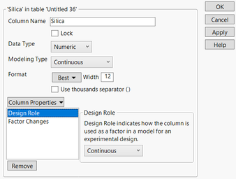

The format of your JMP datatable should be like this :
  • Factors table (one column for each factors, one row for one level):
    Here there are only two levels because the factors are 2-levels continuous factors. Some column properties need to be set :
