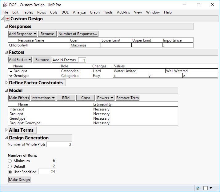

Well, I wish you were using more than two whole plots, but I understand that you have a practical constraint.
Here is a custom design definition that I think captures the essential characteristics as you explained them.

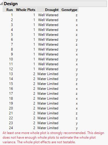

This design is the result.
The warning in red is by the custom design. Here is a script that will re-produce the custom design platform for you to study and possible use. You can copy it here and paste it into a new script window.

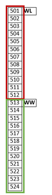

I am really not sure of how to set the nature of my experiment up in JMP for proper analysis. Like earlier posts I have 3 genotype of a crop having 4 replicates each, subject to two different drought treatments. (Main factors: Drought treatment and Genotype). I have attached a view of my field map. Green represents the Well water and Red represents WL.
Thank you
