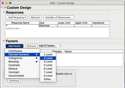

As Dan suggests, you can add quadratic terms to the model you want to estimate, or you can add Discrete Numeric 3-level as in attached pic.

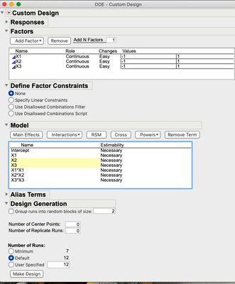

Re: Custom DOE - Issues with Continuous Factors, Runs only at Extreme Value
Screen shot of adding "powers"..2nd.
