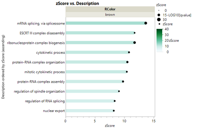

Dear JMP Community,
I thought I knew Graph Builder, but I encountered an annoying behavior with Y-labels of differing lengths.
In the example below, I use a Local Data Filter to plot different categories of data (RColor). Each category has a set of labels (plotted as Y-labels) that can vary in length from 8 characters to > 50. As shown in the two graphs below (identical script), the plot dimensions change according to the length of the Y-labels. Is there a way to lock the dimensions of the Y-axis box, or to wrap the long labels to a fixed length? Of note, the "Line Wrap" setting in AXIS SETTINGS does not seem to do too much in my case.
Thank you.
Best regards,
TS

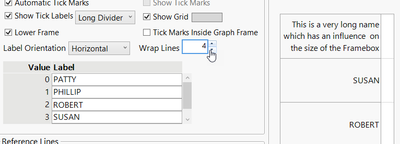

[In Jm18] Wrap lines has an effect :
Depending on the number of labels and the available space, JMP arranges the labels into fewer lines and may even skip part of a label:
(view in My Videos)
If you try to adjust the size of the labels to get graphs with consistent size, you could skip the fist step and use  Frame Size :
Names Default to Here(1);
Graph Builder( Variables( X( :height ), Y( :name ) ), Elements( Bar( X, Y ) ) ); :name[2] = "This is a very long name which has an influence on the size of the Framebox"; current report()[FrameBox(1)] << Frame Size ( 500, 500)

Interesting:
the Size() option in Graph builder controls the green region (including the axis labels).
Via the Frame Size(), one can control the blue region:
And up to now there is no function in JMP to control the purple region:
