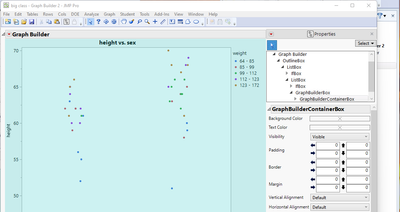

The Size element sest the Frame(FrameBox()) size.
It does not set the GraphBuilderContainerBox()
Which is what I am guessing you expected the size to be set for.

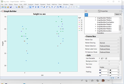

That is the opposite of what I want -- I need the FrameBox() only to be the specified size.  Here is some example code illustrating this.  The Size( 500, 500 ) is fed to both, but clearly the FrameBox() size is very much not (500, 500)
As a matter of fact, it's not even the GraphBuilderContainerBox() that you show that is set to the given size -- you first must remove the LegendBox(), then the remaining (title / axes / axes headers) is set to the (500,500) size.  It is just ridiculous!
There is literally no way to  set the FrameBox() (as in, if you had this within an Outline Box( "", Graph Builder( ... ) ) and did Outline Box[Frame Box( 1 )] << Frame Size( 500, 500 )) BEFORE / DURING instantiation of the GraphBuilder() box.  It can ONLY be done after the window and graph has been created.

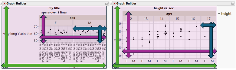

sounds like a candidate for Tiny Traps in Jmp and JSL
green: "Size"
blue: frame size
purple: plot size
Names Default to Here(1);
New Window("test",
H List Box(
Graph Builder(
	Size( 500, 300 ),
	Show Control Panel( 0 ),
	Show Legend( 0 ),
	Variables(
		X( :name ),
		X( :age, Position( 1 ) ),
		X( :sex, Position( 1 ) ),
		Y( :height ),
		Group X( :sex )
	Elements( Points( X( 1 ), X( 2 ), X( 3 ), Y) ),
	SendToReport(
		Dispatch( {}, {"height vs. name & 2 more"}, TextEditBox,
			{Set Text( "my title\!nspans over 2 lines" )}
		Dispatch( {}, {:height}, TextEditBox,
			{Set Text( "very long Y axis title " ), Rotate Text( "Horizontal" )}
Graph Builder(
	Size( 500, 300 ),
	Variables( X( :sex ), Y( :height ), Group X( :age ) ),
	Elements( Points( X, Y ) ),
	SendToReport(
			{Set Text( "x" ), Rotate Text( "Horizontal" )}

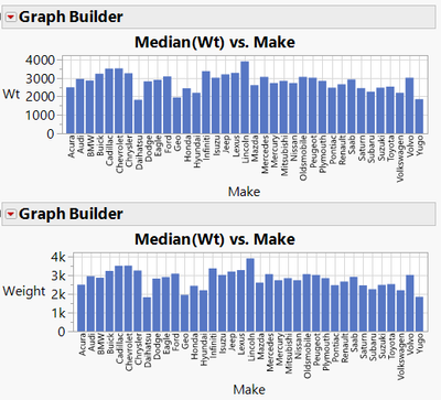

But when I realized that in the Code of @ErraticAttack both functions are used my hope was gone.
In the example, the different X labels lead to completely different sizes of the graph.
As long as there is no rectangl around the whole graph (including the axes), nobody will notice, that both have the same size.
Same issue with different sizes of the Y axis:
Names Default To Here( 1 );
Open( "$SAMPLE_DATA/Cars.jmp" );
New Window( "TEST",
	V List Box(
Graph Builder(
	Size( 500, 200 ),
	Show Legend( 0 ),
	Fit to Window( "Off" ),
	Variables( X( :Make ), Y( :Wt ) ),
	Elements( Bar( X, Y ) )
Graph Builder(
	Size( 500, 200 ),
	Show Legend( 0 ),
	Elements( Bar( X, Y, Legend( 1 ) ) ),
	SendToReport(
		Dispatch( {}, "Wt", ScaleBox, {Format( "Engineering SI", 12 )} ),
		Dispatch( {}, "Y title", TextEditBox, {Set Text( "Weight" )} )
hogi
