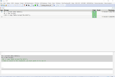

The ultimate goal here is to not have to write the column formulas directly in a script.  I want to copy the calculated columns I made within the jmp table I am working with, and paste them into a new script for when I have to analyze this type of data again.
Here is the screen shot
Just shows three dots ...
I just tested this now on a much smaller data table and it works!  The data table I am working with is 1228 columns x 171,222 rows.
The method of pasting into the clipboard is working for me...  I do put in "No Data" though which is nice.
(Maybe the file I am working with is overloading the memory for the log?  I waited several minutes, with nothing in the log).
